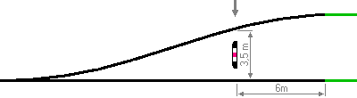

The fouling point is the spot on converging tracks (turnouts, turntables) up to which vehicles on one track will not come into contact with vehicles on the other track. These spots are inidcated by fouling point markers (Grenzmarken).

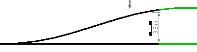

On standard gauge railways a minimum track distance of 3.5 m had been adequate in the past. New protection of labour law is demanding a free space of at least 0.5 m between vehicles on converging tracks. Thus the minimum track distance is now 3.9 m.

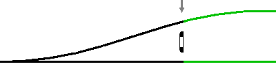

Those fouling point markers which do not (yet) guarantee this new minimum track distance are marked with a red stripe in the middle (so-called »marked« fouling point markers).
The arrow marks the spot where the distance between the tracks is 3.5 m.

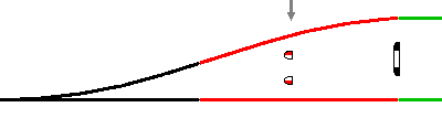

Fouling point marker shifted to the end of the isolated rails (marked red). Additional fouling point marker for shunting. |

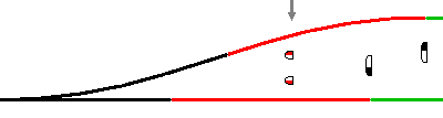

Different position of isolated rails with divided fouling point marker. |

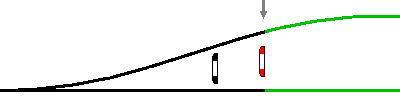

Black fouling point marker for narrow gauge vehicles, red marker for standard gauge wagons. |
