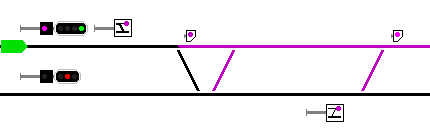

In the examples below all tracks closed to piggy-back trains are marked in violett.
Exit onto the left track. Stop for piggy-back trains.
